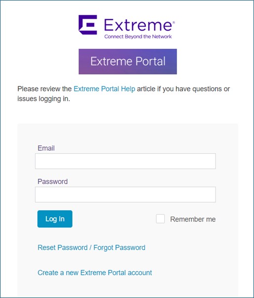

  1. Log in to the Extreme Networks Portal at https://extremeportal.force.com/ExtrLicenseLanding.
  2. If you do not have an Extreme Portal account, select Create a new Extreme Portal account.
    The following figure shows the Extreme Portal login window.

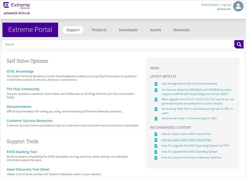

  3. Enter your email and password. Select Log In.
    The Extreme Portal home page appears.

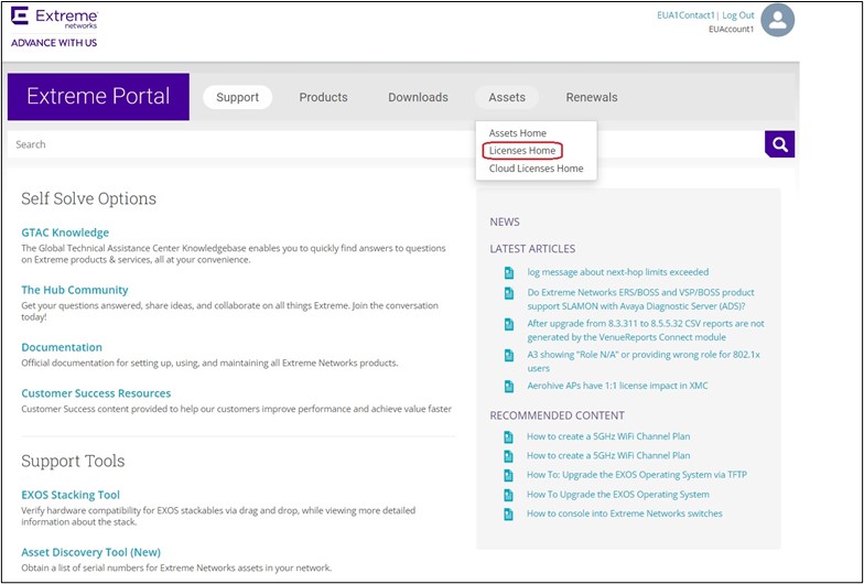

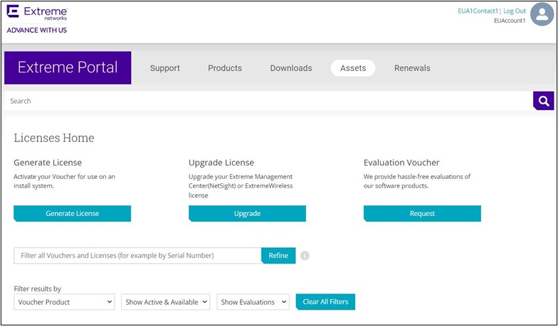

  4. Select the Assets tab. Then select Licenses Home from the list.
    The Licenses Home window appears.
  5. From the Licenses Home page. Select Generate License.
    The Generate License window appears.

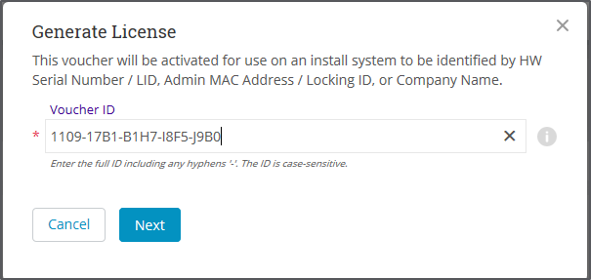

  6. Enter the Voucher ID (VID). Then select Next.
    The VID contains 20 alphanumeric characters with hyphens.

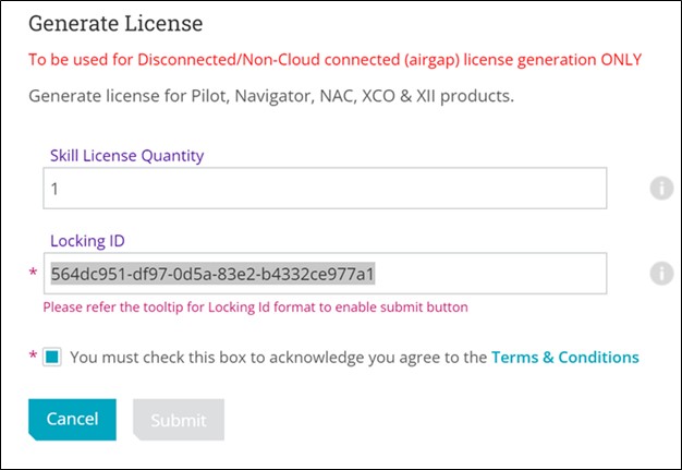

  7. Enter the unique identifier of the HW (or the serial number of the LID). Then select Submit.
    You must check the box to agree to the Terms and Conditions.

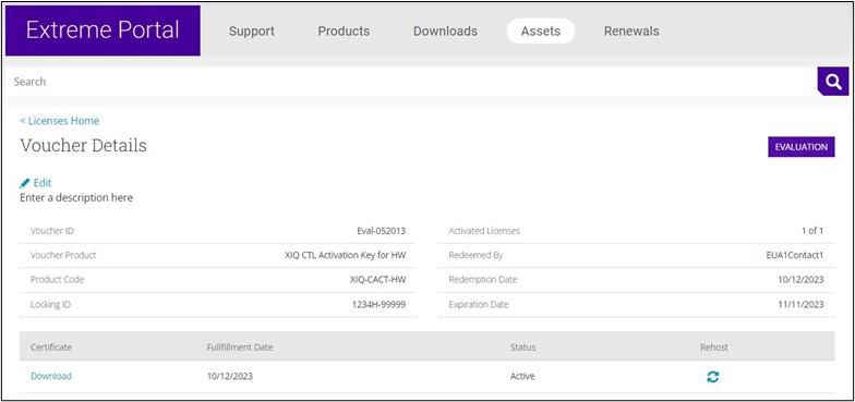

  8. The VID is displayed. The following example shows voucher information for a non-capacity license.
    Voucher Details window
  9. Select Download to download a copy of the license.
    A license can be downloaded after license generation or when a unit is queried. The license is not emailed.
